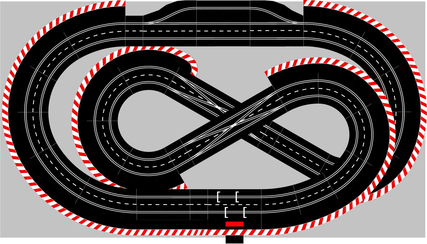

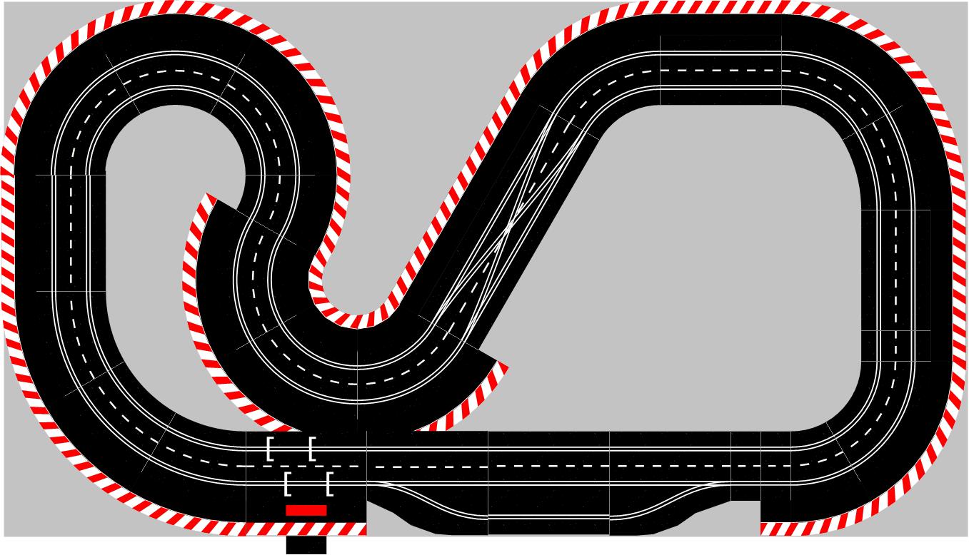

I have a 9ft x 5xft board , its Carrera digital , i have plenty of standard straights,standard curves and 6x r3 30's put happy to invest in more variations to make it work , i would like to incorporate a pitlane.
Thank you.
RE: Newbie Question - MrFlippant - 12th-Sep-23
softyroyal.de is a great web based carrera planner, but you do have to do the designing part yourself. :)
RE: Newbie Question - JasonB - 13th-Sep-23

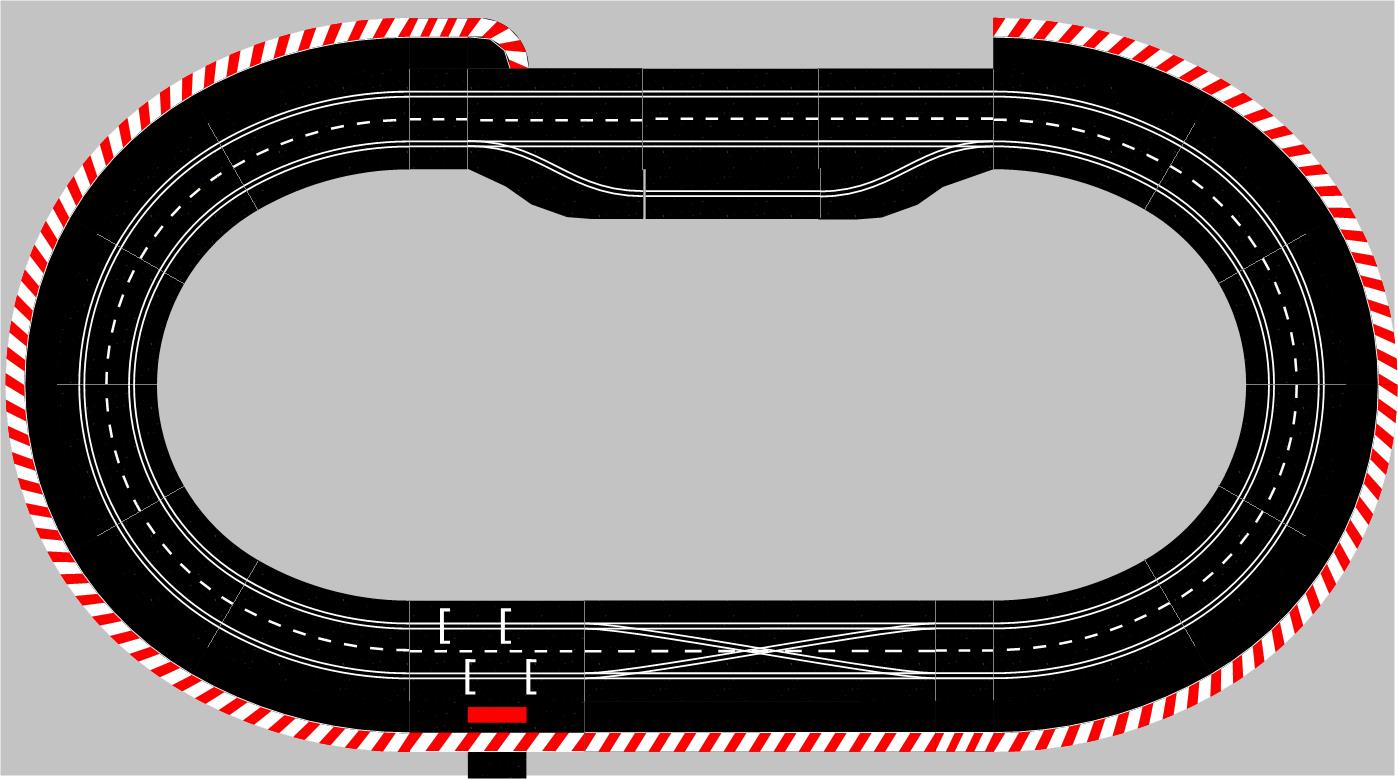

As you are probably aware, Carrera is one of the more difficult track systems to fit into a compact footprint.
If you want a flat track with a pit lane, lane changer, and borders you may be limited to either an oval...
[attachment=31799]
... or using lots of R1 corners.
[attachment=31798]

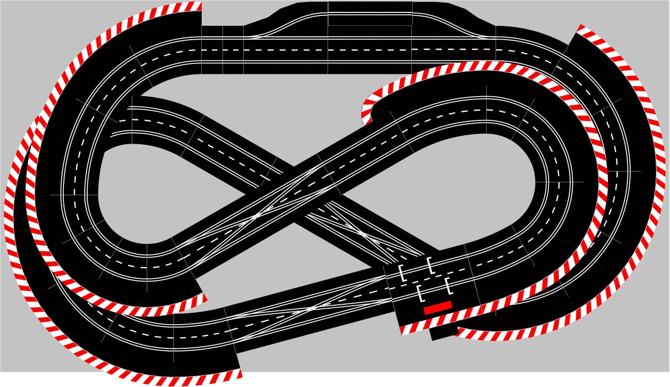

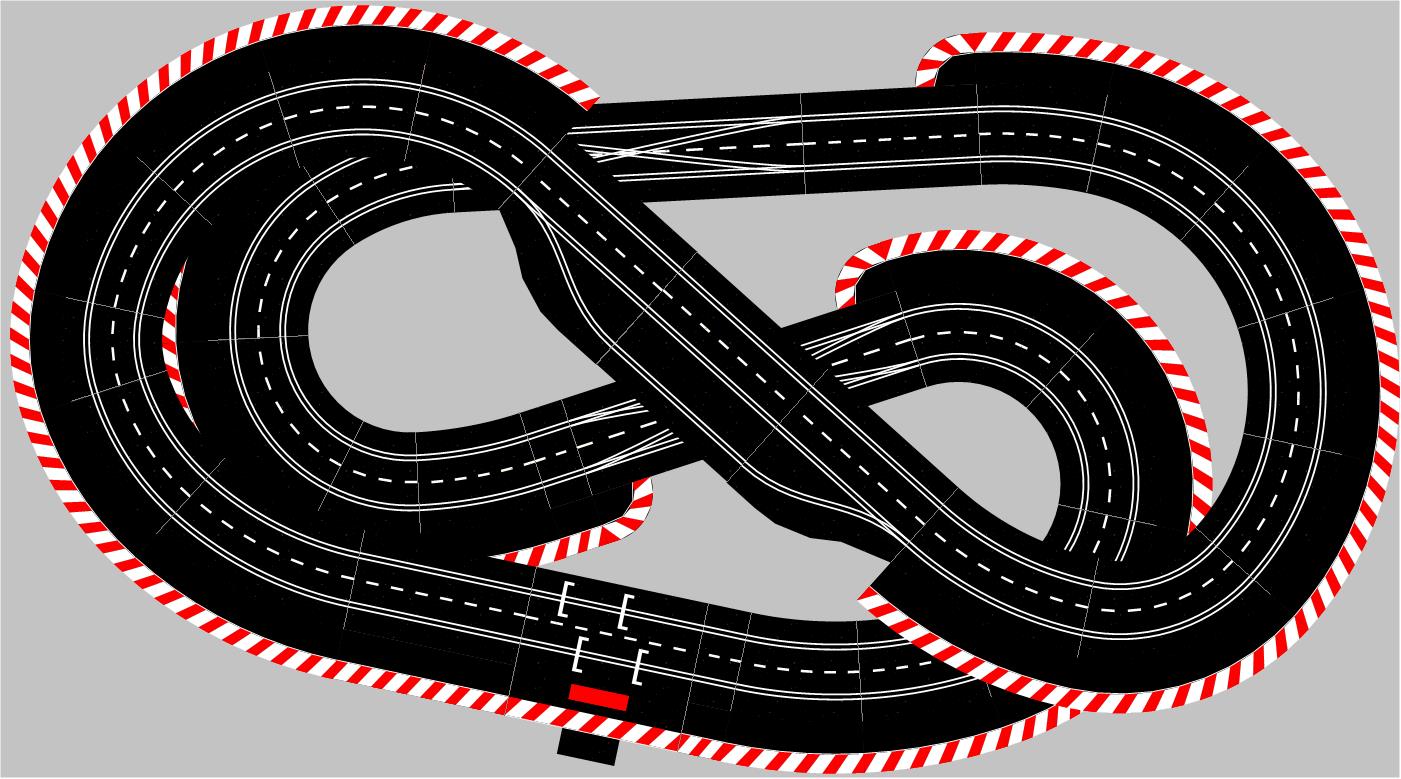

If you're happy to have a multi level track with bridges, then you can fit more track in, but might have visibility issues.
[attachment=31797]
[attachment=31795]
[attachment=31796]
There are places where you'd want longer straights before the lane changers and pit lane entrance, but I'll leave it to the digital experts to advise you on that.
