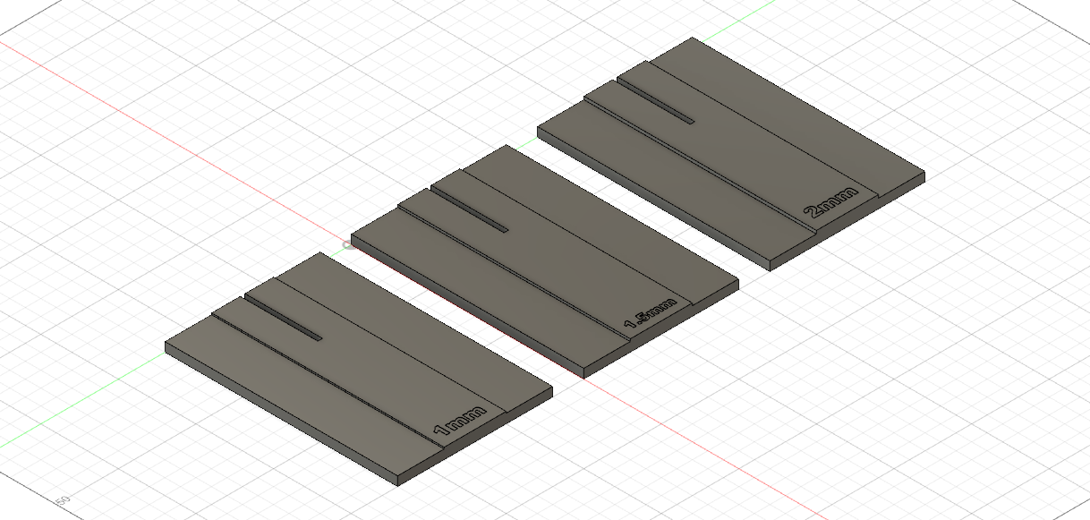

Hopefully a helpful tool for someone...maybe useful for proxy organisers.
Ground Clearance Blocks.
Three sizes, 1mm, 1.5mm and 2mm
Best printed on an FDM printer
[attachment=26821]
[attachment=26825]

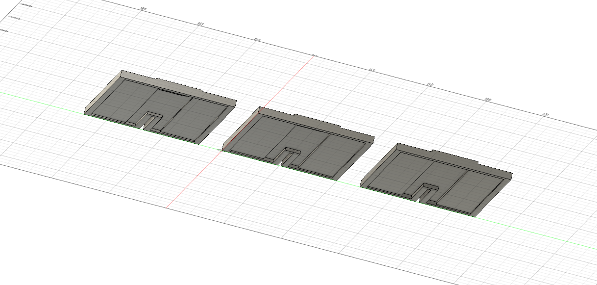

RE: Ground Clearance Blocks - Kevan - 26th-Nov-22
I've tweaked these slightly for narrower cars, these three files now have a 30mm wide top face...the original files had a 40mm wide top face.

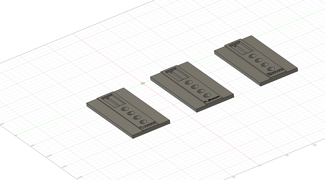

RE: Ground Clearance Blocks - Kevan - 28th-Nov-22
Revisited again after printing and testing it needed to be stiffer and have a slight recess to allow for the guide/braids so the car sits on all 4 tyres and not the guide.

RE: Ground Clearance Blocks - MrFlippant - 28th-Nov-22
I like these latest ones, but shouldn't the braid rebate be lower than, if not level with, the road/track surface? The 1mm has it level, but both the 1.5 and 2mm have the braid rebate above the track surface. If you want to make sure the guide/braid is not effecting the clearance check, I'd think it should be lower than the track surface.
It could go all the way through I suppose.  I left a 1.5mm one print before leaving for work this morning, I'll see how it works later...  Thumbup

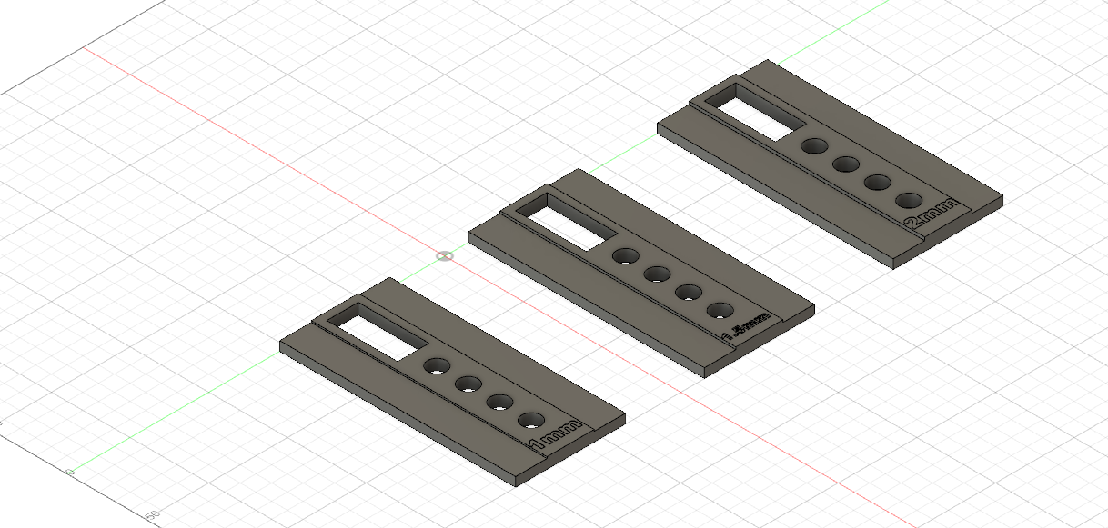

Total clearance of the guide
[attachment=27575]

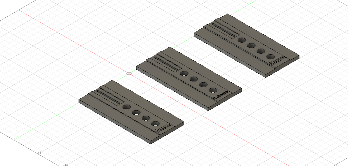

v4...guide braid clearance 2mm below the track surface.  I wanted to keep a slot so you can flip the block over and use the other side also.
[attachment=27580]
RE: Ground Clearance Blocks - MrFlippant - 30th-Nov-22
Perfect!
