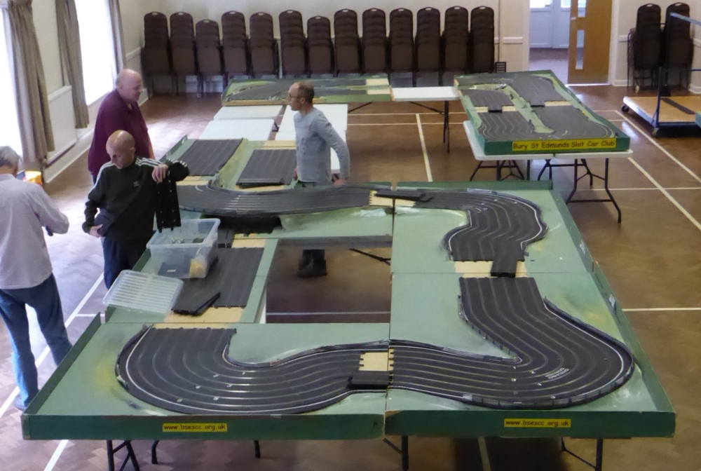

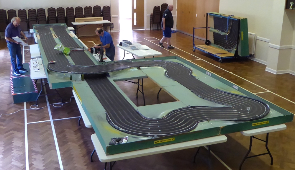

Top Down - 20th-Jan-20
Ah! Forgot to put it in context. No magnets, Scalextric Sport track.
... and here are the two track configurations. Each can be raced in either direction but generally it's coming down the main straight towards the camera.
