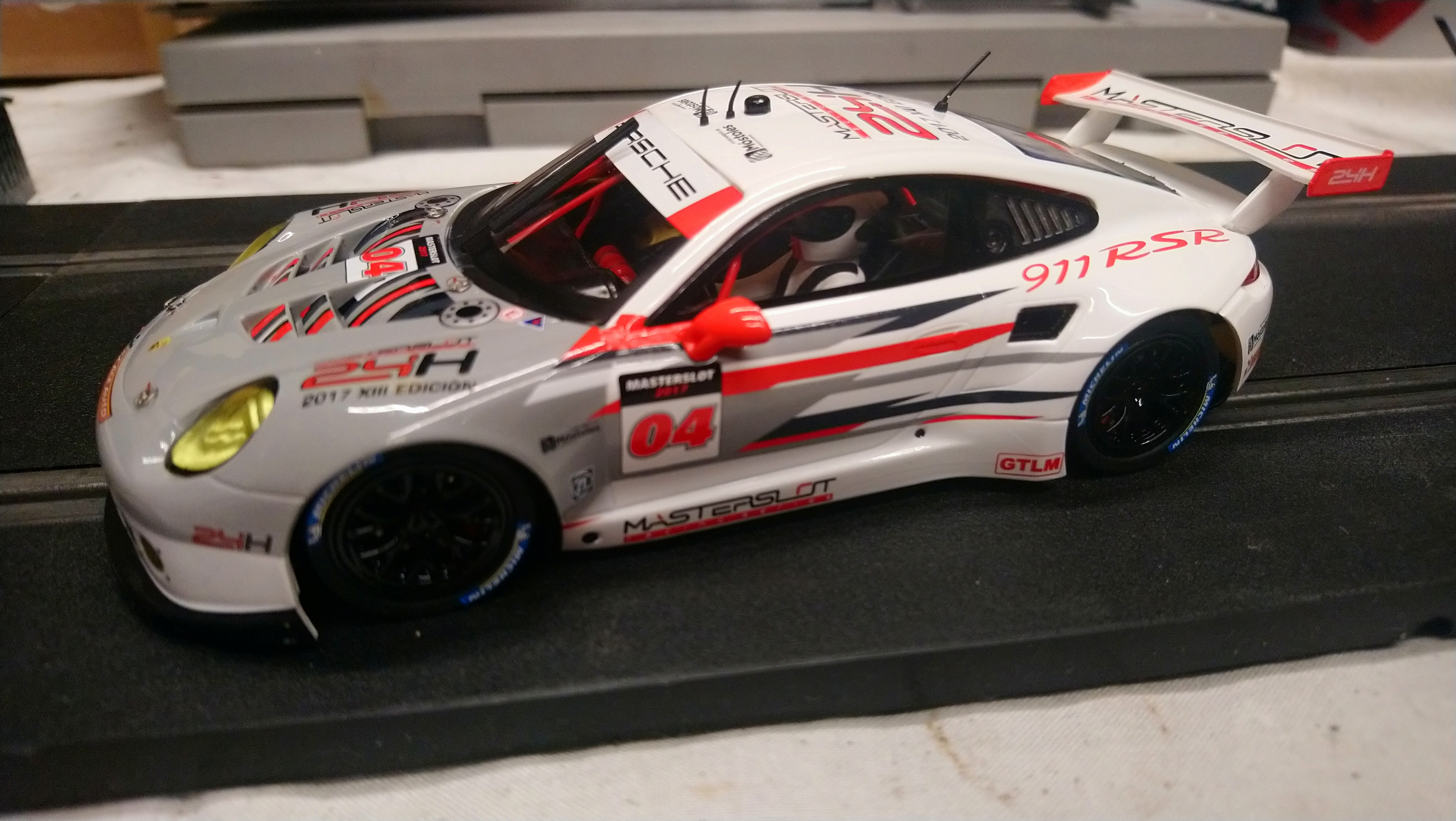

I took two examples of the ScaleAuto models of Porsche 991 GT cars for a tune and test comparison.
This is for wood track racing, so obviously non-magnet, and some priorities will be different to racing on plastic.
First I am opening up this "Home Series" car, to see what you get for about what a basic Scalextric will cost you. **
I used this particular livery, because it was from a ScaleAuto/IBB event I attended, the Campeonato de Espana de Slot.
A huge event with over 500 entrants, hosted at their complex in Iguelada in Spain - about 90 minutes inland from Barcelona.
Lots of fun, even as a spectator.

Everything reassembled, front axle height set, about 6 grams of lead added just behind the guide as first estimate, It spins up very smoothly
on my static bench, and on the resistance board it shows no signs of anything untoward under load. Ready for a track test.
Where The Rubber Meets The Road
Thanks to Peter for the use of Circuito Bahia Vista for testing the Porsche.
Circuito Bahia Vista is a very technical 20 metre track with about 10 turns, and only two places you can open the throttle - briefly. The car
sits nice & low, and first laps told me it is easy to drive. It was pretty smooth first up, and my only fiddling was with the amount of body float.
Once I had familiarised myself with the handling on track I was able to go sub 7 seconds, ending up with a 6.8. The only things I think it
needs now, are a little more weight up front - I think another 2-3 grams behind the front axle; and I will need to add a dot of glue to one rear
wheel as all my assembling and disassembling has left it with a not very tight fit on the axle and it began to work loose under cornering load.
All in all, the car is pretty competitive with only the addition of some better rubber, weight, soft braid, and a swap to grub screws for setting the front
axle height. I am pleased with what can be achieved with a Home Series car and a bit of track tuning.
